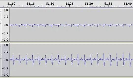

I am a graduate student attempting to take electrophysiology recordings from a lobster under water. In the current set up I am using, two differential amplifier boards are attached the the lobster's back in waterproof casing, with a transmitter and power source in a float being towed around the water surface.
The amplifier boards function properly for bipolar EMG recordings when the lobster isn't in the water, but once the lobster is submerged with the amplifiers on its back, I pick up very large amounts of sinusoidal 60Hz noise as well as a 60Hz "clicking" noise (see attached image). The sinusoidal 60Hz noise I can filter out post recording, but I haven't found an effective way to remove the clicking noise. Both are drowning out the desired physiological signals.
NOTE: the amplifiers have bandwidths of 200-1000Hz, but no 60Hz notch filters. I've run trials with the reference electrode in the salt water, but also bipolar tests with both electrodes placed in the target muscle tissue.
From what I've read I imagine the salt water is amplifying the ambient 60Hz noise, which causes it to increase in the recording once the amplifier is submerged. However, I'm still trying to figure out what about my circuit may be causing the clicking/clipping 60Hz noise. Please let me know if you have encountered noise like this in the past, and if you have any advice on how to address it!
60Hz "click" noise

    Ground loop through the lobster? Just joking. Actually, it would be through the water. Are you using a PC or a laptop to do the recording? If laptop, try running it just from battery power. If the 60Hz interference goes away then it was a ground loop. – JRE Jun 29 '15 at 15:47
    Could be related to a power supply somewhere. Can you sketch out your setup? – Spehro Pefhany Jun 29 '15 at 15:48
  • Isn't it the AC frequency of mains? – User323693 Jun 29 '15 at 15:48
  • Yes, as the others have said, my guess would be noise through your power supply or a completed connection (through the ground of your circuit) and the 60hz mains noise the water is picking up. – Jarrod Christman Jun 29 '15 at 15:51
    A hint would be the lobster twitching uncomfortably at about 60 times per second. Check for mains wires hanging in the tank. :-P. It is, if you are in a 60Hz country, very probable to be related to mains. Salt water isn't very good at small-loop inductive coupling, but very good at electrical coupling and reasonably good at capacitive coupling, which also works through plastic tank walls. We need to see a complete socket-to-socket sketch to make the proper suggestions. – Asmyldof Jun 29 '15 at 16:04
  • As other have said, post a sketch of the setup. Maybe some photos will be better, given the very unusual situation. – LorenzoDonati4Ukraine-OnStrike Jun 29 '15 at 16:23
  • Are you *sure* that the clicking noises aren't action potentials? – Scott Seidman Jun 30 '15 at 15:29
  • Also, that clicking may be happening at 60Hz, but it has much higher frequency content than that. I suspect a 60Hz Notch will be of marginal help. – Scott Seidman Jun 30 '15 at 16:19
  • @Benjamin -- those look a WHOLE LOT like action potentials. Id move my electrodes to a different part of the lobster just to make sure that you're not looking at action potentials that happen to be firing at 60Hz. – Scott Seidman Jun 30 '15 at 18:44

Lastly, those look a WHOLE LOT like action potentials. I'd move my electrodes to a different part of the lobster, or just hook them up to a dead piece of meat, just to make sure that you're not looking at action potentials that happen to be firing at 60Hz.
