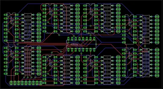

So just for practice I decided to design a 64-output mux in Eagle, I figured if its good it could be useful in the future. I did not use auto-router.
Here is the PCB: pcb (Click to zoom in)
To the lower left are the interface pins: power, gnd, selectors.
It consists of 2 levels of 8-output muxes (9 total).

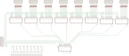

Here is the schematic it's based on: schem (Click to zoom in)
The size of the layout is 4.4" x 2.4" which would get really expensive to get printed for an amateur. I kind of get the feeling this whole idea is impractical, but I don't know what to think. Does it even make sense to do this?
Is this a good design?
I'm planning on using this to make an 8x8x8 LED Cube. Would this design cause too much propagation delay since the traces weave in out through vias a lot?
Is there any way I can make this even more compact or efficient? Or just any general improvement?
Any input is appreciated! Thanks!

No, it's not a good idea. First you're using analog multiplexers which have a rather high \$R_{ON}\$, like 125\$\Omega\$. You're passing two levels of them, so that will be 250\$\Omega\$. Nothing to worry about, you could say, I'll need a series resistor for the LED anyway. Right, but you'll also have to drive a high current through it. You're multiplexing 64 LEDs one by one, so that's a 1.6% duty cycle. You'll have to pulse them with high currents to get some light out of them, possibly even high enough to seriously shorten the LED's life.
A better solution would be a matrix. The columns could be driven by a ULN2803, which can sink high currents. You could switch columns on one at a time, and for the rows set the row outputs high for the LEDs you want to light in the current column. So a row will only drive 1 LED at a time, a column 8 LEDs at a time. Your duty cycle has increased to 12.5%, so you won't need that excessively high peak current anymore. Yet it will still be more than your microcontroller can deliver, so you'll need a PNP transistor for each row.
Since you'll be driving only 1 column at a time you can use a demultiplexer like a 74HC238, so you'll need only 3 lines for that. Together with 8 row lines that's a total of 11. That would be OK for 64 LEDs, but you'll need 8 of them for the 8x8x8 cube, and that would be costly in microcontroller output.
Solution: use SIPO (Serial In-Parallel Out) shift registers like the 74HC595 for the row data. Cascade them for the 8 matrices, so that you can shift 64 values through them. When the last bit has been shifted in you latch the data and select the column. While the LEDs for this column are on you can already shift in the data for the next column. At the time cue latch the data, and again select the next column.
Alternatively place the 74HC595s in parallel and shift 8 bits simultaneously in them. This will need 8 bits of your microcontroller's I/O instead of just 1, but you won't need 64 shift operations, only 8.
Note: you'll need a ULN2803 per 64 LED matrix; it can't drive 8x8 rows.

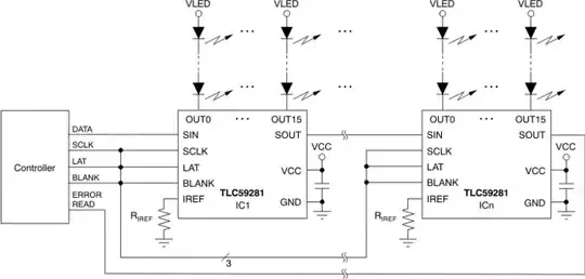

  • TLC59282 16-Channel, Constant-Current LED Driver Texas Instruments' TLC59282 is a 16-channel, constant-current sink driver. Datasheet here. Each channel can be individually controlled via a simple serial communications protocol that is compatible with 3.3 V or 5 V CMOS logic levels, depending on the operating VCC. Once the serial data buffer is loaded, a rising edge on LATCH transfers the data to the LEDx outputs. The BLANK pin can be used to turn off all OUTn outputs during power-on and output data latching to prevent unwanted image displays during these times. The constant-current value of all 16 channels is set by a single external resistor. Multiple TLC59282s can be cascaded together to control additional LEDs from the same processor.
  • TLC59281 . Similar.

Aside from the issue that this is not the way to drive LEDs, when designing a PCB for large channel counts, you need to use a bottom-up approach, starting from the layout, not a schematic with nice, logical or arbitary pin assignmants. Channel mapping can be done easily in software, so lay out the PCB in whatever way makes the tracking neatest and easiest, then back-annotate to the schematic and use a lookup table to map it.
