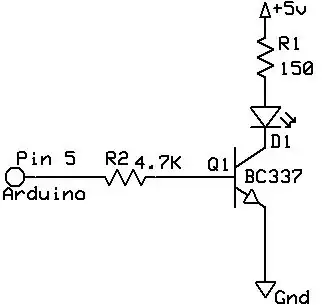

I am actually working on a project with an RGB LED strip that requires 12V. I am using a 2N2222A (NPN BJT). A MOSFET will not draw current at the GATE, but a BJT will draw a small current through it's base. They are super cheap and super simple. I took this off the internet, but it is a similar setup:
Since LED's are current driven, this is a good example of "Turning" on and off the current. If the voltage at the base (Which is called gate for MOSFET's) is high, then current will flow. If the voltage is low at the base then no current will flow, the BJT will act like an open circuit. Keep in mind that you may still have 12V sitting on your LED, but because the BJT is open it will NOT allow current to flow, thus not illuminating the LED.
Also keep in mind, that since you are using an RGB LED you will need 3 BJT's for each LED strip. Good thing 2N2222A's are fairly cheap!
Hope this helps. Please let me know if you have any questions. I am going through a similar project at the moment so I might have some answers or advice as to why I made certain design decisions. Good luck!
