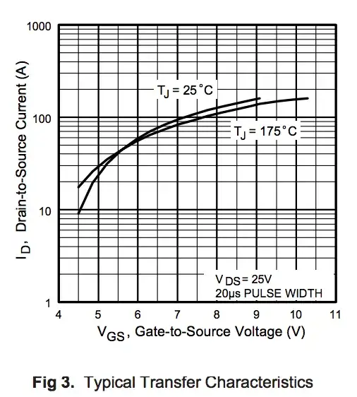

To figure out if the FET is suitable, you need to know how much current you plan to draw, then look for the graph plotting "typical output characteristics":
Look for a line corresponding to the gate voltage you plan to use - in this case, there isn't one low enough - and look for where the curve flattens out. If that's at a current level greater than the amount of current you need to supply, you're good. Alternately, look at the "typical transfer characteristics":
This plots maximum current as a function of gate voltage, so you can trace a line from your MCU's gate voltage - 3.3 volts - to determine what the maximum current level at that gate voltage will be. Again, in this case, the plot doesn't actually go low enough to evaluate that on this particular FET.
Keep looking - there are FETs that meet your requirements - and remember that everything depends on how much current you plan to conduct.
