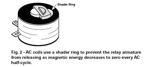

sorry, I misread part of the question (ie it works at 60hz but not at 120). Yes part of the field collapses, there is usually another coil that produces a field out of phase of the main excitation field. This contributes to the retaining force and thus allows the relay to ride through zero crossings of the AC http://www.britannica.com/technology/shading-coil – Jun 26 '15 at 14:21

AC coil relays have inductance as well (the DC relays have inductance as well, of course, but it does not affect the 'on' current). They also typically have a shading ring that acts as a shorted turn in order to cause a magnetic field 90° out of phase with that from the coil, so that the total magnitude of flux does not drop to zero at the zero crossings.

In theory AC coils can be driven with DC as long as you limit the DC coil current to the level of the AC holding current (to keep the coil from overheating). For larger relays i.e. contactors, a DC current limited to the equivalent AC holding current is often insufficient to actuate the contactor effectively. Since the coil inductance of the contactor increases once the contactor is closed the AC holding current is less than the AC pull in current. DC contactors usually have some mechanism to shift between a coil pull in current and the holding current. This is the difference between an AC coil and a DC coil in large relays. The flux shunt (shader ring) is external to the coil and only shorts a portion of the core.
