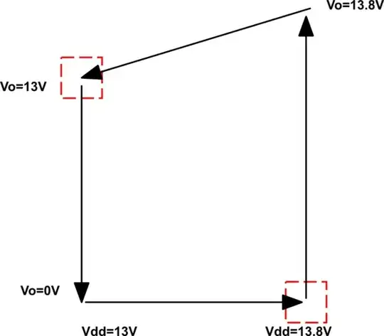

Use a low-power reference such as a fixed, 2.5V LM4040 for your negative terminal. This draws as little as 45uA typ, though you'll want to exceed its max of 60uA in the worst case. Your threshold analysis will need to take into account the two different supply voltages expected at each threshold. In other words your hysteresis curve will not be rectangular but will look, crudely, like
with transition analysis points in red. A possible solution for this system is
