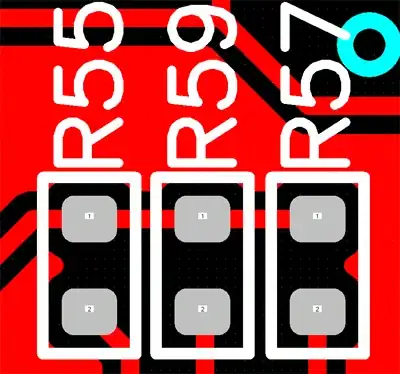

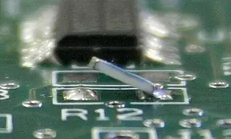

A colleague has (apparently unsuccessfully :-)) tried to convince me of the risk of tombstoning
tombstoning
in the following situation:
PCB detail
He claims pad 1 for R55 and R59 will lose heat faster during soldering because they have two traces leaving, while pad 2 only has one, and that this would cause tombstoning. Frankly, I've never noticed anything like it, even these 0402 resistors lay perfectly flat on the PCB. Am I too careless?
(The traces are 0.2mm wide)
edit
I could also have shown 0402 parts with one pad connected via 4 spokes to a copper pour, which should be even worse, but again no problems whatsoever.

  • Tombstoning prospects increase with decreasing component size due to decreased energy of retention from surface tension forces compared to the self centering forces which will cause tombstoning if a mechanical imbalance occurs. 0402 appears to be about the point where you really start to care (although with due lack of care some manage it at 0603 :-)) and with 0201 it really matters. If you are "real enough" to be using 0201 you probably have other even more important matters to care about !
  • There are far more factors involved than just cooling rate, and it's very very much a case of "YMMV", but you'd be wise to pay some attention to your friend - while it's not necessarily liable to be an overwhelming issue, there are so many factors that if it happened to occur frequently in your case you would not be totally surprised.

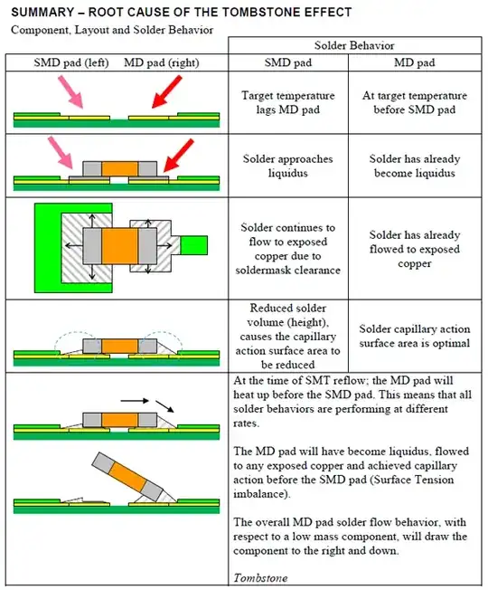

This July 2011 white paper agrees with your friend. The Low Mass Solution to 0402 Tombstoning
In summary it says:
  • Variations in the components [thermal characteristics] must be accounted for in the pad geometry, or else tombstoning may occur. He also recommends treating each pad as a group, and ensuring the copper density of each pad is equal (or very close), meaning both pads achieve the same temperature and liquidus at the same time. Also, Reno says, both pads should achieve solder flow to exposed copper at the same time, and be equal in solder volume necessary to control capillary action.

Glossary:
  • MD = metal defined. Relates to PCB pad. Whole of available metal area is pad with no solder mask limiting pad extent.
  • SMD = solder mask defined. Metal extends beyond pad area defined by solder mask.
  • YMMV = your mileage may vary = caveat emptor = what you experience may be different to what I experience etc. USA origin. It's a wry comment, almost a cynical joke based on US auto advertising claims. viz In our test Model XXX auto got 56 mpg on an urban cycle driving test - YMMV. ie While WE got 56 mpg, you may not.

The only case of tombstoning I have personally seen was a board designed by a customer before I got involved with them. The problem there was that the inner edges of the pads were too close to each other. The manufacturer pointed this out to us, and there were fewer problems on subsequent boards with this fixed. The better footprint turned out to be close to the recommended one in the resistor datasheet. Apparently the original engineer never looked at it, or made the pads too big for whatever reason because he imagined it would be better. Those were 0603 parts. Of course this problem is worse for smaller parts like 0402.
If you're not sure on something like this, ask the assembly house. They deal with good and bad footprints every day and usually have a good idea what they can build reliably and what causes trouble.

I thought that the whole point of following the reflow solder profile during the cooldown phase was specifically to avoid this kind of thing - it ensures that all the components and their solder joins cool at a steady temperature instead of some cooling faster that others by regulating the cooling of the ambient temperature.
Of course, if you're not using reflow then controlling the ambient temperature is hard...
One thing your colleague failed to take into account... As R59 will be inducing heat into the copper track, some of that heat will go in to R57. Some of the heat from R55 will go into R59, etc. So the overall difference in temperature and cooling - if the components are heated together with hot air, for example - should (I would have thought) be minimal. The difference in cooling would only be an issue if the track was able to leach the heat away, which it won't if the track is as hot as the components and their solder.
