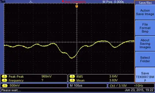

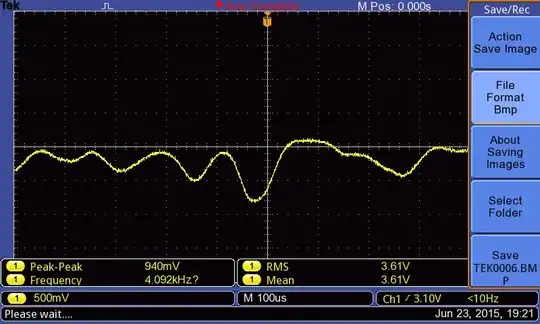

Here are the waveforms that I got after randomly shouting at the mic while connected to laptop. I took the readings from Pin 2 and 3.
Pin 2 reading
Pin 3 reading

Before plugging in the mic, the voltages at pin 2 and 3 float around 4.8V but as soon as I plug the mic in, the voltage drops down to 3.7V.

Typical USB sound cards have an earphone jack and a microphone jack. Since it works with your microphone, it is set up to deliver power to the electret microphone - hence the 4.8 Volts when open. That is to say, the sound card is delivering DC Voltage to your microphone.
The microphone input of a sound card can't supply much current, but it is enough for a small transistor amplifier. If fact, electret mics all have a single FET transistor amplifier attached to them - the signal from the mic itself is very high impedance and requires that little amplifier to deliver low impedance signal. You might stretch a point and find a low power op-amp that will work with 3.8V and damn near zero current, but I bet your pocket book will say "ouch" if you go that way.
Picking up a voice from across a (normal sized) room shouldn't be a problem, though, even without a preamplifier. The mic can pick it up easily, and the sound card will digitize it. What you hear has got relatively little to do with it, however. It might well pickup and be capable of recording a voice that you can't hear when played back through the speakers. You can amplify the signal digitally, however.
The sound card samples at 16Bits, which gives you a lot of room to amplify things digitally. All you need to do is multiply the incoming samples with some number to amplify the signal. Need 20dB of gain? Multiply your samples by 10.
A better microphone shouldn't be neccessary, unless the one you've got is just utter crap. I use a 20 year old electret mic from an old Toshiba laptop for my experiments - it can pick up voices from all across the room, even if I can't hear them on playback through the speakers. A little digital gain, though, and all is good.
If you actually do go the preamp route, you will probably need to consider using an automatic gain control. Cranking up the amplification until a voice from across the room gives you a full scale recording means that noises closer to the microphone will overload it and you'll just get a distorted mess. Again, digital amiplification can save your bacon. An AGC in software isn't that hard, so just take advantage of the 96dB range of that sound card and do the amplification digitally.
