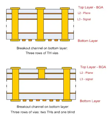

I think the main problem is: vias could occupy significant space from other components, thus a larger board is necessary.
On the first picture a TH vias allow us only four pads to be placed. But with a blind via or without a via we have place for six (or more if we have more rows) pads. A larger BGA component could be placed here this way. source
And at the end reduced size means reduced cost.

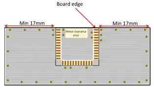

I wouldn't say that vias are bad. They are not!
One useful way to use vias is to shield RF energy in a RF board, a technique called via stiching:
