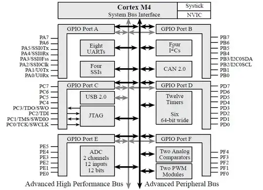

I have not work much on 8051, AVR, or PIC. But recently I have started looking at the ARM Cortex MX line of processors. Therefore I cannot tell you much about transition from 8051, AVR or PIC, but mostly from a standpoint of a beginner.
The ARM®Cortex™-M4 processor is base on Harvard architecture, thus has separate data and instruction buses. Below is an high level image.
This week NXP represntatives will be visiting our facility. I will check with them for any NXP ARM-Cortex Mx resources and post them here. Freescale has Kinetis Low Power 32-bit Microcontroller (MCUs) based on ARM® Cortex®-M Cores, I understand they also have similar guides to learning ARM processors. Unfortunately I have not research them.
