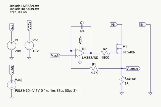

This is the circuit schematic as simulated and tested on the breadboard:

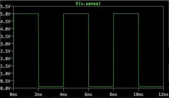

The plot produced by LTSpice indicates the circuit is quite stable. There is a 1mV overshoot on the 5V rise that resolves in one cycle. It can barely be seen without zooming in quite a bit.

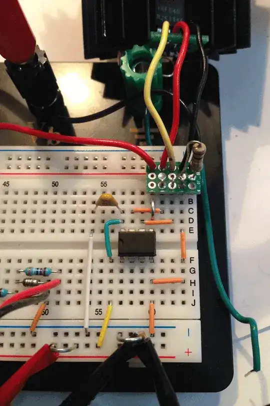

This is what the breadboard build looks like:
The MOSFET is at the top on a heatsink, connected by the yellow, red, and black wires; gate, drain, and source, respectively. The red and black wires leading to the small proto-board are IN+ and IN- respectively, connected to the breadboard banana jacks to avoid power-level current through the breadboard. The power source being loaded in the test is a sealed lead-acid (SLA) battery, to avoid any instabilities in the power source itself. The silver jumper is where the square-wave is injected from my function generator. The resistor, diode etc. on the lower left is part of a manual (potentiometer-based) load level setting sub-circuit and is not connected.
My main question is: Why does LTSpice not predict this significant instability? It would be really handy if it did because then I could simulate my compensation network. As it stands I just have to plug in a bunch of different values and re-test.
My main hypothesis is that the gate capacitance of the IRF540N is not modeled in the SPICE model and I'm driving a ~2nF capacitive load that's not accounted for. I don't think this is quite right because I see capacitances in the model (http://www.irf.com/product-info/models/SPICE/irf540n.spi) that look to be the right order of magnitude.
Any way I can get the simulation to predict this instability so I can also tune in my compensation network values?

Ok, it turned out that the LTspice model I was using for the LM358 op-amp was quite old and was not sophisticated enough to model the frequency response properly. Updating to a relatively recent one by National Semi did not predict the oscillation, but clearly showed the 20% overshoot, which gave me something to work with. I also changed the pulse peak voltage to match my breadboard test, which made the overshoot easier to see:
LTspice plot with better LM358N model
Based on that "feedback", I started with the unanimously recommended compensation method which I believe is an example of dominant pole compensation. I'm not sure if the gate resistor is part of that or a second compensation scheme, but it turned out to be critical for me. Here are the values I ended up with after a fair amount of trial and error:
Compensated schematic
This produced a very stable waveform, although I'd like to get the rise and fall a bit sharper if I could, to better test the frequency response of the power supplies I'll be testing with this load. I'll work on that a bit later.
Compensated LTspice plot

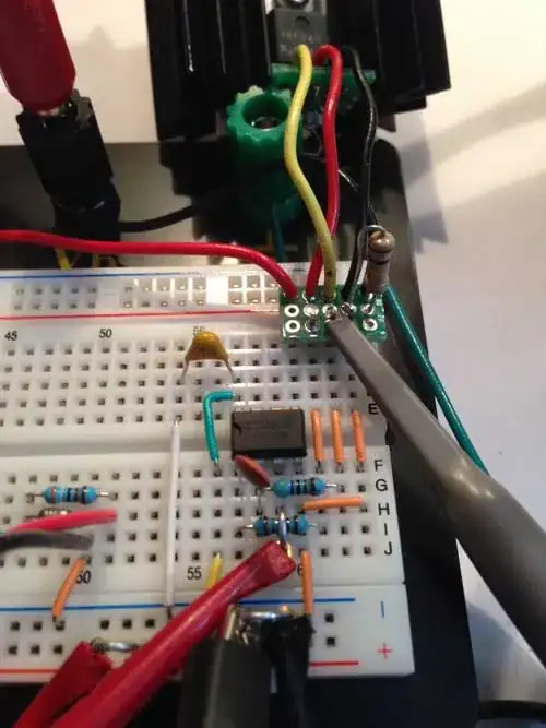

Especially since, to fit in the new components, I made the breadboard parasitics worse rather than better:

    LTSpice doesn't understand the inductors (aka wire jumpers) between your breadboard and the MOSFET. It also doesn't understand the likely tortuous path that 0V takes when using a breadboard. LTSpice WILL model gate capacitance and it's also worth noting that the source resistance will put a medium value resistor in series with that gate capacitance. – Andy aka Jun 22 '15 at 07:26
    The IRF540 model I have used (PSpice) contains a bulk-gate cap of app. 2nF, a gate-source cap of 1.1nF and a gate-drain cap of app. 0.5nF. I suppose, the problems arise due to breadboard parasitic L and C influences. You should reduce the occupied area (shorter connection wires). – LvW Jun 22 '15 at 07:54

    ADd a 0.1uF low ESR cap with minimum possible series L from op amp Vcc to ground. It may **look** physically similar to the one connected to Vcc now but without the immense coupling loop and long breadboard tracks. It will probably plug in across the IC body from pin 8 to pin 4 and look ugly, but work semi-infinitely better. Then add the large electrolytic cap across the power supply rails where the Vcc line enters the breadboard power rail. If you can bring yourself to wire it, for now, in an ugly looking way from pin 4 to tin 8 as directly as possible that may help, ... – Russell McMahon Jun 22 '15 at 20:10
    ... but odds are the 0.1 uF you have there now (in place of the prior L + C) will help enough. If that hasn't helped or helped enough try a say 10 Ohm resistor from opamp output to FET gate. That's usually to stop things a bit more spurious and with less reason than the oscillation you are seeing. | It probably is well down the list of most relevant points but grounding both the inputs of the unused opamp is not a bad idea, (probably :-) - ie Murphy sometimes has other ideas). Report back ... . THEN you can look at the "what is wrong with my intended circuit Q&A that others are dealing with. – Russell McMahon Jun 22 '15 at 20:15

There are different models for the LM358 unit. PSpice simulations based on "LM358" result in a phase margin of app. 50...60 deg. But apparently, this is a very simple model.
However, when using the LM358/NS model the margin is slightly negative! This explains the observed instability during measurements. Hence, external stabilization of the feedback scheme is necessary.
Compensation: A compensation scheme (series connection R=500...1000 Ohms and C=50...100nF) at the opamp output node provides a phase margin of app. 50 deg. (simulation).
