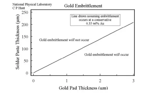

Also found this graph: enter image description here
I still dont know if this would be worthwhile though. Does anyone have experience with gold embrittlement or lack thereof?

It certainly can be a problem. You might try http://www.semlab.com/papers/goldembrittlementofsolderjoints.pdf for one technical discussion. As far as I know, the reliability risks are not time-dependent. The gold does not diffuse through the solder over time.
