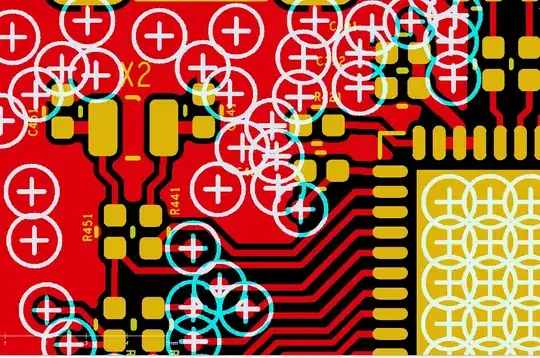

I use a 32.768 kHz SMD crystal (datasheet) for a MCU. Here is the layout part of the crystal.
Here is a view from an actual PCB

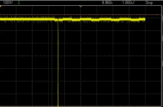

Most modules' crystal didn't start working at the beginning, but I solved it by re-soldering the crystal by applying a little bit more solder under it. The interesting thing is that when I touch a pin of the crystal by a tweezers, the crystal starts working. Here is an an oscilloscope view of the crystal's signal.
The glitch is where I touched the path by a tweezers, and then the oscillation starts.
Another fact is that some of board's crystal work if I touch to the C451 cap's path, some of them start working if I touch to C441 cap's path (e.g., if it works by touching the C451 cap's path, it does not work if I touch to C441 cap's path).

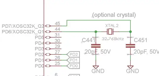

EDIT2 Here is the gerber view of the reference design of TI, as it is an optional crystal, it is connected through 0 ohm resistors(R451, R441) enter image description here

  • Are the picture & photo of the same PCB? The picture made me a bit nervous about ground connection of the left (vertical) load cap, but on the photo I see a big ground plane that is not present on the picture? Doesn't the chip have a ground pin for the oscillator that should be directly connected to the caps, not via a big ground plane that carries other currents? – Wouter van Ooijen Jun 18 '15 at 12:37
  • I placed a better screenshot of the board. Thank you for the warning and recommendation about the layout. I placed a screen shot of from the reference design, the return path goes to the ground-plane (under layers don't have a specific path) – Angs Jun 18 '15 at 12:57

Your layout looks a lot worse in the screen shot than it actually is with the ground pour, however I'd still try to isolate the ground return from the load caps and have it go right back to the ground on the chip. I'd also like to see a ground pour under the caps and crystal (maybe you have one) and connected to the same ground point as the load caps.
