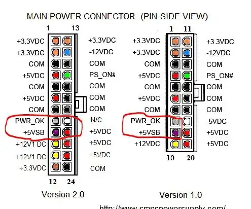

Edit: Now that we know that your circuit board is an ATX power supply the simplest debugging suggestion is to check if the 5VSB (Stand by supply) is active. With the multimeter check if you have 5V on this line. Below are to images to help you.
ATX power Supply -1 ATX power Supply -2
