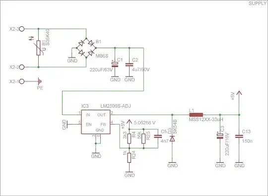

Another approach would be to buy a module that uses an LM2596 regulator (or build a circuit using that regulator). There are such modules available cheaply from China (eg. eBay)n, though I believe the 'LM2596' is typically a counterfeit.
The schematic would look something like this:
Though you'd probably want to increase C1 to 2200uF/25V or more.
If you buy a module the parts after the bridge rectifier and C1 are in the module. You can also buy kit power supplies that are missing all but the transformer.

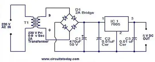

The LM7805 circuit would be more like the below (again with C1 increased to more like 2200 or 3300uF/25V).
The LM7805 will need a heatsink maybe 100mm x 100mm 3mm thick aluminum plate or thereabouts.
