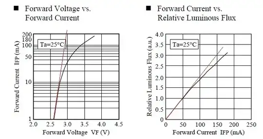

These curves are for the utterly marvellous [tm] Nichia NSPWR70CSS-K1 LED mentioned below. Even though this LED is rated at 60 mA absolute maximum and 50 mA continuous max Nichia have kindly specified it's performance up to 150 mA. Longevity at these current is "not guaranteed". This is about the most efficient <= 50 mA LED available. If anyone knows of any with a superior l/W at 50 mA and in the same price range, please advise!
I use the Nichia "Raijin" NSPWR70CSS-K1 LED in several products. This started life as an 30 mA LED but was uprated to 50 mA by Nichia after testing (with reduced lifetime of 14,000 hours). At 50 mA it delivers about 120 l/W and at 20 mA about 165 l/W. The latter figure puts it amongst the very best real world products available, although recent offerings are now exceeding this value at well below rated currents.

I didn't make up these figures. They can be found in the Panasonic LN222RPX datasheet:
I want to make two notes here:
  1. half the value seems like a big difference, but you'll have to remember that our eye perceives light intensities logarithmically; if doubling the intensity is 1 step then the difference between a dimly lit room (10 lux) and bright sunlight (100 000 lux) is only 13 steps. One step will be less noticeable than the numbers suggest.
  2. There's also the other graph, forward current vs forward voltage. Like for any other diode the voltage increases with increasing current. That means that power dissipation in the LED will increase more than proportionally with rising current.
If we stop here we could conclude that pulsed current is worse than continuous current, luminosity-wise and power-wise. BUT!

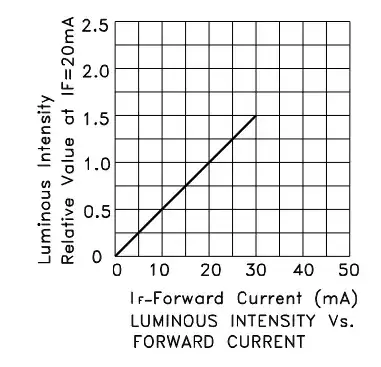

Kevin came with this graph from a Kingbright datasheet:
That curve is damn straight! For this LED (and others from Kingbright I checked) luminosity is perfectly linear with current, so pulsing should give the same result as continuous current.
conclusion
Apparently not all LEDs are made equal. While it makes no difference whether you pulse or not for some LEDs pulsing may give worse performance for others. However, I haven't found LEDs where performance increases when pulsing.

    I think it's not so much that some LEDs have linear brightness as a function of current whereas with others it tails off at high current. I think all LEDs do this, but for some the normal operating range is in the low linear region. I think Kingbright dumbed it down to a straight line because at 30mA that LED sees little falloff. If you could run it at higher currents I'm sure there would be falloff, but there are other limitations to prevent you from doing that, or more likely that Kingbright doesn't want to bother specing at. – Olin Lathrop Jul 29 '11 at 15:53
    @Olin - I see what you mean, but for the Kingbright it's perfectly directly proportional over the full DC range (30mA is Absolute Maximum DC current), and the Panasonic doesn't show this even at low currents. – stevenvh Jul 29 '11 at 16:02
    I suspect Kingbright simplified the data. – Olin Lathrop Jul 29 '11 at 17:05
    Ouch! That goes right against my Beliefs that a datasheet should be correct or should not be at all! :-) – stevenvh Jul 29 '11 at 17:11
