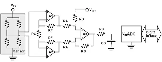

As for amplifying the signal I'd use an instrumentation amp (inamp) like this: -
It's basically 3 op-amps connected as below: -
There are plenty of options and optimization or best choice of inamp relies on knowing the power supply you have available for your project.

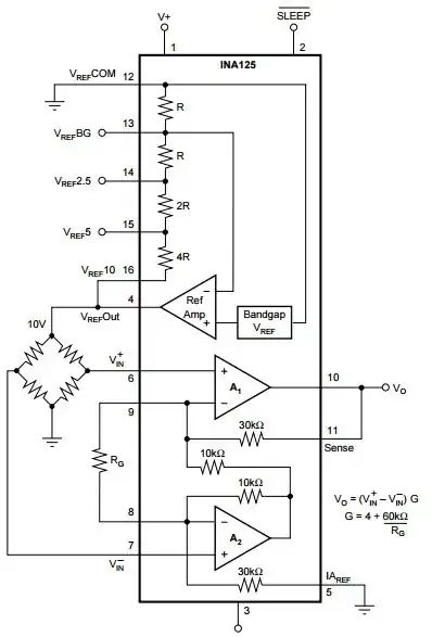

Four load cell ( half bridge strain gauge sensor) needs to connected as in figure to form a full bridge. That means connection is fine according to the diagram. Wiring these sensor to the amplifier is a bit tricky. Arduino has 10 bit ADC which should be okay for the low level application like yours. I have made my own digital weighing scale using these sensors. But i had used ADS1130 and at89s51 microcontroller. INA125P should work but you need to configure it carefully. Reading the voltage with Arduino is easy but configuring it with INA125 is difficult, (I don't know why, it never worked for me).You can read the datasheet of the instrumentation amplifier and follow what it suggest.
[from the datasheet] enter image description here
