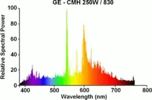

Here is the spectrum of a lamp from wikipedia. Lets try to find the power density of the "green light"
lamp spectrum
This is in arbitrary units, but no matter, if you integrate it you get the total power of the lamp. My digit-oral-integrator says the total power under the curve is about 6000 nm.units. The integral of the "green light" between 510 and 550 nm is about 800 nm.units, or 13% of the power.

Putting it all together: say you have a 2000 lumen metal halide light with the spectrum above. The number of "green" photons emitted per second can be found by google:
"2000 lumens / (82 lumens/watt) * 800/6000 * 630 nm /planck's constant /speed of light" which says 1019 "green" photons/second.
