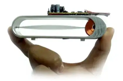

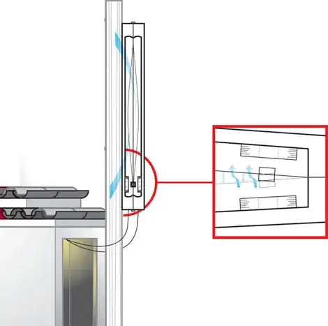

WINDBELT
I would have noted the windbelt if it seemed liable to be a useful addition. It may be, but unfortunately, probably isn't at this stage. I'd be keen to use windbelt technology if it looked useful and cost competitive. So far it seems to be neither except perhaps in some very very niche applications.
As will be seen, real world performance of available demonstration modules is under 5% of that of the modestly dimensioned system that I claimed above - ie what you can actually buy is as far below the performance of alternative systems as it claims to be above them.
The Windbelt [tm] has its place and is a clever idea BUT unfortunately a vast amount of rubbish and many spurious claims have been made and continue to be made. Claims about efficiency compared to other systems are either "just plain wrong" or are perhaps based on special circumstances which are never explained and which are in any case suspect.
Windbelt promotional literature claim them to be 10 to 30 x miore efficint than microturbine systems. Given ~=60% max possible efficiency (Betz limit) a claim of 10 to 30 x more efficient than microturbines suggests uT's get 1%-3% efficient IF a windbelt is say 30%.
Here's a real world humdinger microbelt with very similar area to nthe one described above but AC (not DC) energy outputs 20 or 30 times LESS than the conservative example I gave above )
 Wind Turbine versus / Windbelt claimed milliWatts
  • 1 m/s ..... 0.3 / -
  • 2 m/s ..... 2.5 / -
  • 3 m/s ..... 8 / 0.1
  • 4 m/s ..... 20 / 0.5
  • 5 m/s ..... 40 / 1.5
  • 10 m/s ..... 300 / 8
If you allow for my calculated figures being high by a factor of 10 (2% efficiency rather than 20%) then the wind turbine (aka modest sized fan) compares more than favourably with the windbelt published results.
It has been long enough now since original announcement that you'd expect some substantial real world products to be appearing. You can indeed buy some small demonstration units, such as the 8 mW at 10 m/s unit listed above. But the cost is closer to $20,000/Watt than $2/Watt. A look at the websites "Coming soon" promises shows that the dates are well expired. More's the shame. A breakthrough of this sot would be most welcome. But it does not appear that this technology is going to deliver it any time soon, alas. Watch this space :-).

Instead of a turbine, you should consider a wind belt.
Prototypes of the device are claimed to be 10 - 30 times more efficient than wind microturbines.
endolith
  • 28,494
  • 117
  • 181
    Wiki says it can be built for $2 a watt, that is amazing! – Kellenjb Jul 26 '11 at 14:08
  • See addition to my answer under "Windbelt" . The Windbelt [tm] has its place and is a clever idea BUT unfortunately a vast amount of rubbish and many spurious claims have been made and continue to be made. Given ~=60% max possible efficiency a claim of 10 to 30 x more efficient than microturbines suggests uT's get 1%-3% efficient IF a windbelt is say 30%. This is manifestly incorrect and should "red flag" all other claims. See answer above. – Russell McMahon Jul 26 '11 at 22:49
