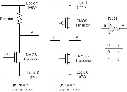

Likewise, for CMOS
D refers to the drain, and
S refers to the source.
For bipolar logic like TTL this is correct; even for push-pull outputs ("totem-pole") only NPN transistors were used and \$V_{CC}\$ is indeed connected to collectors.
But for CMOS \$V_{DD}\$ is actually a misnomer. CMOS is much more symmetrical than TTL, and while the source of the N-MOSFET is connected to \$V_{SS}\$ it's not so that \$V_{DD}\$ is connected to the drain.
CMOS inverter
Due to the symmetry it's actually connected to the source of the P-MOSFET. This is probably an inheritance from NMOS, CMOS's predecessor, where \$V_{DD}\$ was indeed the side of the drain (with a resistor in between).
