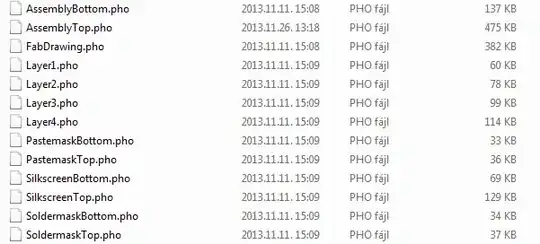

I have downloaded the design you are dealing with. The gerber files, all layer files have .PHO extension.
Import gerbers into Altium
If you rename the files as follows you will be able to open them in Altium:
  • Layer4.pho \$ \longrightarrow \$ Layer4.GBL, this is the bottom layer
  • Layer1.pho \$ \longrightarrow \$ Layer1.GTL, this is the top layer
  • Layer2.pho \$ \longrightarrow \$ Layer2.GP1, GND plane 1
  • Layer3.pho \$ \longrightarrow \$ Layer3.GP2, GND plane 2
  • SoldermaskBottom.pho \$ \longrightarrow \$ SoldermaskBottom.GBS
  • SoldermaskTop.pho \$ \longrightarrow \$ SoldermaskTop.GTS
I have identified the layers by the PDF appendix. For Pastemask (GBP, GBT) and Silkscreen layers you should search for their Altium extensions.

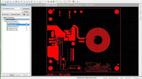

These modified files can be dragged and dropped into Altium, example for Top layer:
This way all layer files are easily openable in Altium.

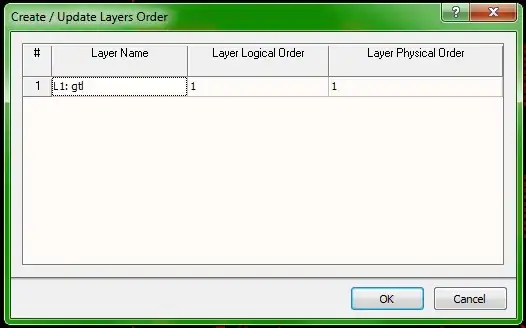

  2. Select the Menu → Tables → Layers Order option. Following dialog will be shown: Fill the cells as below.

  4. Now, select Menu → File → Export → Export to PCB and a new PCB document will be opened with the Top Layer.
    Result:
