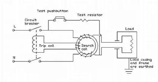

ELCBs - lifesavers Where it DOES work is if ELCBs (Earth leak circuit breakers) are equipped. An ELCB detects the imbalance in current between phase and neutral (go and return) that occurs when a person diverts part of the current from the live circuit to ground. ELCBs are designed to trip at currents below that liable to be drawn by a person contacting mains. They are designed to trip in less than the time taken for one "heartbeat", thereby removing (theoretically) the ability to cause cardiac fibrillation. You can still feel the kick ! - ask me how I know :-). [[Back of clenched fist testing probably allows you to check this. YMMV. Don't try this at home. Ouch!]]
The above diagram is from "Electric Shock Protection"
