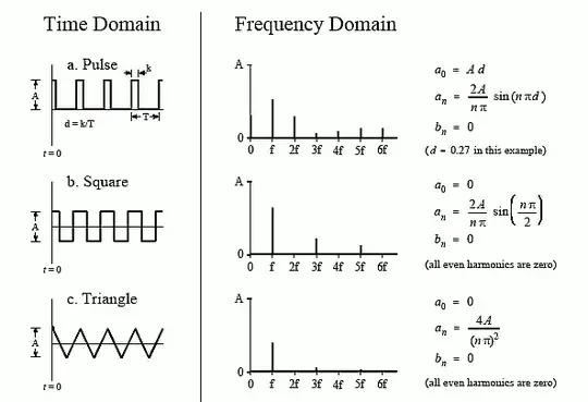

It's also worth pointing out that data is hardly ever a perfect square wave; more likely it is a quickly changing pulse waveform so, I'm also showing below the spectrum shape for a generalized pulse: -
For non 50:50 waveforms (i.e. non-square) both odd and even harmonics are generated. I've also shown the triangle spectrum - it is of considerable interest when the digital data is slew rate limited in order to restrict the bandwidth. Compare the spectral content between this and the square wave directly above. Picture taken from here
