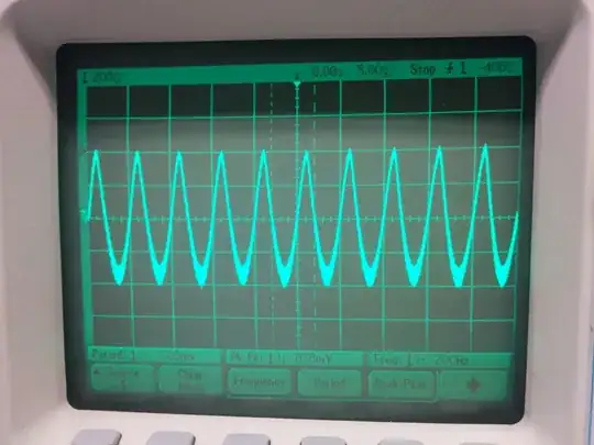

Here is a scope shot of the start of a typical transmission sequence:

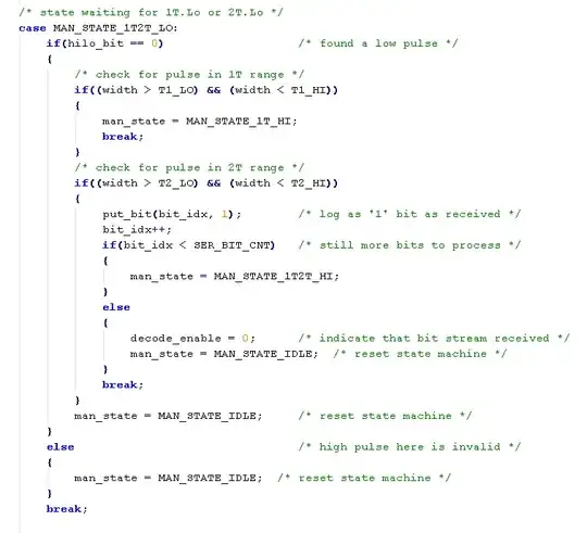

As I described before the receive decoder measures the width of each received pulse width and determines its nominal 1T or 2T width by comparing the measured value against an acceptable range. The wider you can make the acceptable pulse range the more robust the decoder algorithm can be in dealing with distortions of the received modulation waveform. You still want to keep a cap on how wide you make the tolerance so that the decoder is actually picking up the intended pulses and not some random output from the receiver. The code to check for the pulse widths in a particular state looks like below. The state machine is called from the interrupt context that occurs at each falling and rising edge of the input waveform.

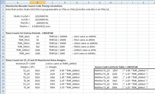

I've used a spreadsheet to compute the pulse range values and exported that as a set of defines that equate the widths based upon counts in the MCU timer used to measure the widths. Here is a sample of the calculations for one target receiver I produced.
RF transmissions using 433MHz are typically line of site for detection by the receiver. In one of my applications where the path between the transmitting MCU and one or more of the receiving MCUs was obstructed by large metal / concrete building structure I built a repeater module that receives the RF packets and re-transmits it 2 seconds later. Whilst I could have built the repeater using another MCU I had actually decided to build it around a low cost FPGA development board purchased on eBay. It was an interesting exercise done with schematic design at the top level and a number of Verilog modules to perform the Manchester decode and encode state machines. The following snippet shows how close the Verilog state machine code looks as compared to the same decoder state shown above in C code.
In the case of the Verilog sample the measured pulse width was performed in another module and the comparision results sent as signals to the state machine decoder module.

  • On your scope traces why does the receive input (CH4) start toggling before the transmitter starts keying (CH1)? – Andy aka Jun 02 '15 at 13:37
  • @Andyaka - The scope triggered on the XMIT channel 1. The stuff you see on the receiver output is the random noise picked up by the receiver. If I recall correctly the receiver acts strange staying low and bursting high with noise or staying high for long periods and bursting low with noise. The scope probe clipped to the xmit antenna is not seeing everything because it is just a 200MHz scope. – Michael Karas Jun 02 '15 at 17:57
  • @MichaelKaras It's no problem, just looked odd as if the triggering on the scope were all wrong - just a coincidence that the receiver "sprang into action" at that slightly eary point but as you said (and I said in my answer) the rx output can be full of noise/crap etc.. – Andy aka Jun 02 '15 at 18:12
