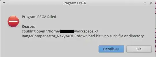

When I click "Program", I get this error:
Program Error
According to this post on the Xilinx forums, I shouldn't have to worry about the download.bit file if all the fields of the program FPGA dialog are populated, yet it download.bit doesn't seem to be getting generated.
How can I resolve the error during programming?

  • A quick and dirty way of doing it is to clean up you project, then chose Download from the Tool menue, this will regenerate all the files, creates teh bit file, merges it with your SW and programs the HW. – FarhadA May 31 '15 at 10:43
  • The file is called RangeCompensator.bit but Impact is looking for download.bit... does renaming the file work? If so, that's a workaround, but I'd still look for a cleaner solution (tell Impact to look for the right filename) –  May 31 '15 at 11:05
  • @FarhadA There is no "Download" option in the SDK's "Xilinx Tools" menu. I assume you meant "Program FPGA". Either way though, cleaning the project had no effect. – skrrgwasme May 31 '15 at 17:52
  • @BrianDrummond Renaming the file worked. I don't see where or how the intermediate tools are invoked. Do you know how I can update Impact to look for the right file? – skrrgwasme May 31 '15 at 17:53
I never did find a great solution for this, but as suggested in the comments, renaming the "RangeCompensator.bit" file to "download.bit" worked.
If you encounter this issue, renaming the *.bit file that is present is a workaround.
