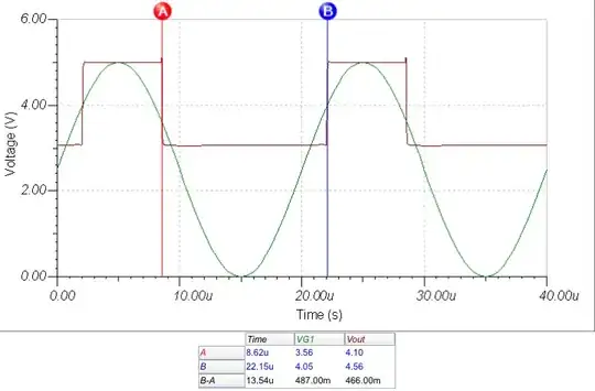

I designed a Schmitt Trigger with discrete components (using an emitter-coupled pair) that operates with a Low Disable Trigger of around 3.5V and a High Enable Trigger of around 4V on circuit simulation. The circuit simulation uses a sine wave function generator to simulate a changing analog waveform.
Schmitt Trigger Circuit (flawed)
The desired output of the Schmitt Trigger for high and low are 5V and 0V respectively, but this Schmitt Trigger outputs a logic high of 5V and a logic low of 3V, which is not suitable for the rest of my circuit, as they require 5V-0V logic levels to work.
Circuit Simulation Graph
The question is how can I make the Schmitt Trigger output a logic level of 5V-0V from a logic level of 5V-3V? What circuit can I "bolt on" to this design to make it output that logic level, or even better, an entirely different circuit altogether that achieves similar functionality (a discrete-component comparator that can achieve a 5V-0V logic level is also cool with me).
Keep in mind that I cannot use any ICs due to project requirements, and I also cannot use any other power supply other than 5VDC.

The basic problem is how the positive feedback in your Schmitt trigger robs low output voltage. The feedback voltage is generated across RE, which is always added to the low level output voltage.

RE (plus transistor base) sets the lower trigger point. Reduce this to ~56R for (falling) triggering at ~3.5V with ~0.3V low output.
Adding a small resistor between T1 collector and T2 base allows fine control of the hysteresis; 100R will give (rising) triggering at ~4.5V with 5V output.
R1, RC1 and RC2 can be increased quite a lot to reduce power wasted, but will interact a little with the triggers - simulate and hand tune.

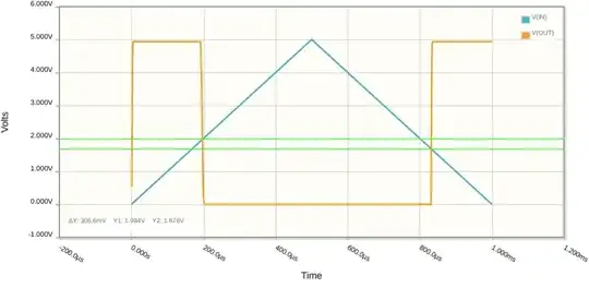

You could use a negative supply (about -3V) to offset the low output level downwards by 3V, but this will alter the switching thresholds, and by readjusting all the resistances to restore them, you also change the low output level. It's a balancing act.
Much easier is just to add a third transistor stage (blue box below) to obtain 0V and +5V from +5V and +3V inputs:
However, that stage inverts, so now you have an inverting schmitt trigger:
If you require non-inversion, another inverting stage will correct it:
