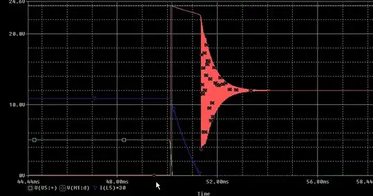

Edit: Below is a PSPICE simulation I did with similar parameters to yours (I used a 1N4740 Zener and a PHD23NQ10T,118 MOSFET to save me time). Green trace is the gate drive signal (before the resistor), red is the MOSFET drain. As you can see the MOSFET drain rises to a peak voltage of around 24V.
In the below close-up, you can see where the bulk of the energy is dissipated and the ringing afterward. The violet trace is the coil current (scaled so you can see it on the same graph).

  • The red line is the 5v "on command", Blue line is the voltage at the MOSFET. Oscillations are happening after the 5v is gone or in other words when the switch is open. The green line is the battery voltage. If you mean the blue square on the circuit, they are nothing... I am not familiar with LTspice... this is the first circuit I have every simulated in LTspice. I don't know why the blue line plunges to zero when I give the 5v command. It only makes the connection to the ground. When I delete the 5v voltage, and MOSFET and make a direct connection to the ground this doesn't happen! – arudino.tyro May 28 '15 at 14:21
  • See edit above with simulations. It might be more clear if you plot the coil voltage rather than drain voltage and the coil current. – Spehro Pefhany May 28 '15 at 15:17
  • Thank you very much for the explanation, help and support. – arudino.tyro May 28 '15 at 16:31
  • Okay, the blue line is the MOSFET drain. When the MOSFET is 'on' (input voltage 5V) you expect it to be close to zero. That means the voltage across the coil is 12V. When the MOSFET turns off the voltage shoots up to the zener +12V voltage then drops back to 12V, leaving nothing across the coil. This is as it should be. – – Spehro Pefhany May 28 '15 at 16:39
