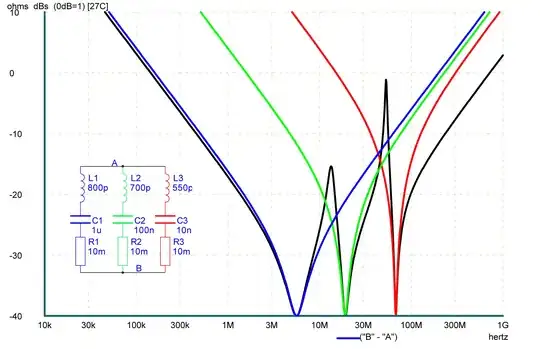

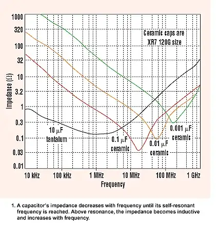

Higher value capacitors will not be as effective at dealing with high frequency current drawn by the chip. Above a certain frequency a capacitor will start to behave like an inductor. The value where its characteristic changes is the series self resonance of the device: -
Thus, you'll find that on microwave devices 100pF capacitors are also present as decoupling along with the bulk capacitors. Here's an example of three capacitors decoupling an FPGA: -
The black curve is the composite impedance of all three capacitors used. Taken from here.
Where did the value of 0.1uF for bypass capacitors come from?
It's a good compromise between bulk and high frequency capacitance BUT if you are designing radios your default decoupler may be 10nF or 1nF (UHF). If you are designing really high speed digital stuff you may also use 2 or 3 different values in parallel like in the FPGA picture above.
    Could you explain why they would start to behave like inductors? Is it because at higher frequencies their impedance would lower untill the equivalent series inductance takes over? – Golaž May 26 '15 at 14:10
    @Golaz - exactly - look at the 2nd graph in my answer - it shows a precise representation of three capacitors and bear in mind that a pcb track may have an inductance of 1nH per mm. – Andy aka May 26 '15 at 14:15
    Note closely the antiresonant peaks in the black curve in Andy's graph -- they are why it's better to use several identical capacitors in parallel than to parallel different value capacitors. (Of course, Ott explains it all quite well in Electromagnetic Compatibility Engineering...) – ThreePhaseEel May 26 '15 at 22:10

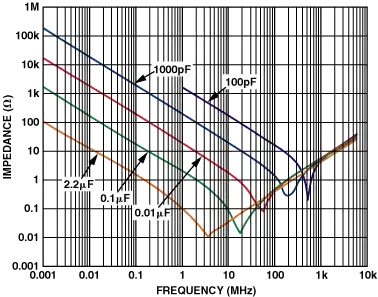

The recommendation to use multiple values, such as 100nF + 10µF, is from the 90s and 80s when 100nF was the highest readily available ceramic capacitor with decent high frequency response. The 10µF capacitor would be an electrolytic or tantalum capacitor with poor high frequency behavior.
That has changed completely today. Now you can easily buy 10µF ceramics in 0603 or even 0402 packages. For ceramic capacitors, the high frequency response has nothing to do with the capacitor value, and everything to do with the package size of the capacitor.
With modern capacitors, it is usually pointless to connect a 100nF in parallel with a 10µF.
You can easily see in the diagram below that modern high value ceramic capacitors are just as good as low value capacitors for high frequencies, as long as the package size is the same. (The small negative dips are the resonance frequencies. You do not want to rely on the resonance frequency for decoupling capacitors, so those dips should be ignored)
Frequency response of modern ceramic capacitors
(Image source: Analog Dialogue Sep 2005 - A Practical Guide to High-Speed Printed-Circuit-Board Layout)
