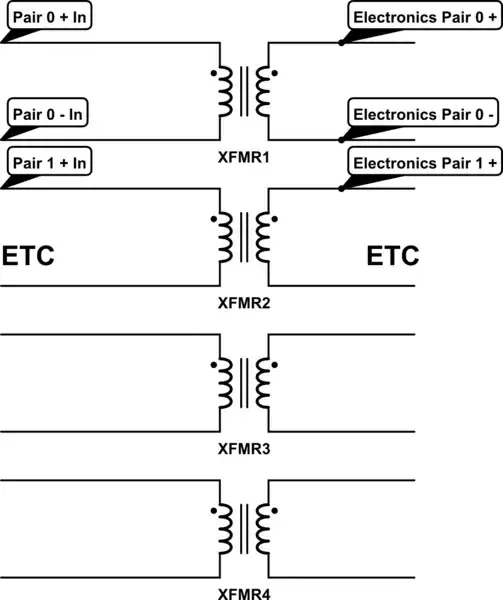

In Ethernet Electronics, whether 10, 100 or 1000Mbit, the signal is isolated using inductive coupling, or transformers.
Ignoring any termination resistances, it can be illustrated like this:
This is to eliminate any risks of DC offsets between two devices communicating over the cabled medium. The high frequency signals pass easily through the magnetics, and the DC is left out.

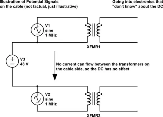

This is then later "abused" in PoE. If you put a DC voltage across two pairs, this will not couple into the electronics on either side, whether they know about the DC or not, as long as if they know, they handle it properly.
Whether type A or type B is used, or both, they will put the positive of the DC on one pair entirely and the negative on another, so as not to cause any high DC currents in the coils imaged above. Since the pairs are terminated with independent transformers, no DC current can flow, unless it is actively sought on the cable side.

One thing is guaranteed, if they adhere to the specification, is that they are forbidden from using a pair to transport the full DC voltage on its own, like this:
simulate this circuit
So, that's why a pair must always have both wires be the DC's positive, or both wires negative, but never both!

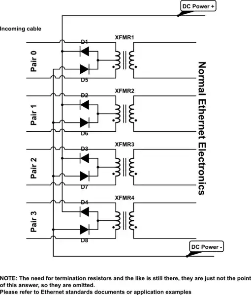

Your schematic, fully compatible with any situation that fits the existing safe practises, would look like this:
Now it doesn't matter which pair is positive or negative, you'll always get what you need, even if a manufacturer interprets proposed DC directions ... "differently"... And you'll get all your Ethernet signals nice and clean into the electronics that handle those.
Even if the supply side dirtily connects the Pairs 0 and 3 hard to DC. It is true that some types of "remote supply" accesspoints of brands like TP-Link do that with the little plastic block they supply for the "PoE". Those blocks often disconnect the outer pairs from the "input side" and connect those to the adapter plug on the "output side". But using PoE magnetics in your device will still allow you to get that DC signal out, but also allows your device to stay compatible with normal Gigabit networks.
