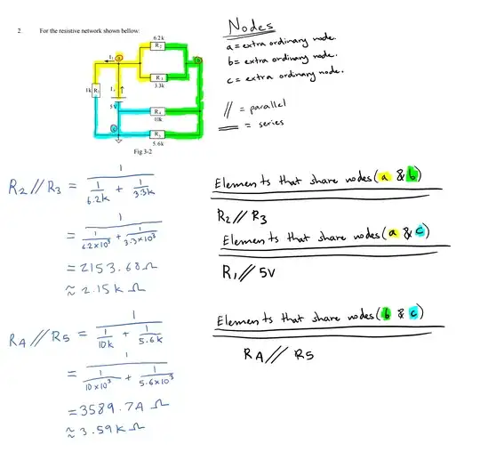

Here's what i've worked out so far.
This is the original circuit .
Maybe I need to calculate the resistor in parallel with the battery, and add it as the total resistance. But how would you calculate that, and would it work?

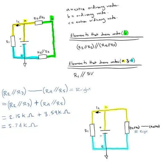

I re-did (R2//R3) in series with (R4//R5). And calculated the total resistance.

You are very close but you made a mistake that is keeping you from completion.
R2 is in parallel with R3 to equal R2||R3.
R4 is in parallel with R5 to equal R4||R5.
Next note that R2||R3 is in series with R4||R5 so these add together as: R2||R3 + R4||R5 to equal RRight.
Finally RRight is in parallel with R1.
I think you can finish from there.
Edit Actually if you are trying to find Vab then use R2||R3 as the top resistor in a voltage divider with R4||R5 across 5V. R1 need not be considered unless you were trying to compute total power consumed from the 5V supply.
