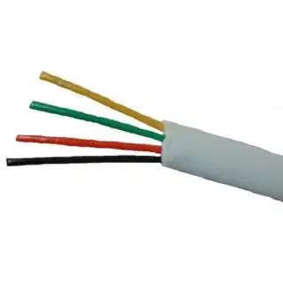

I'm attempting to build a crystal radio,
and I have an old telphone cable with four copper wires, similar to the one pictured.
I would like to use it to build the coil for the set, and I was wondering if it would be possible to use all four wires rather than stripping the entire thing to get one.

  • I suspect the insulation will severely limit the number of turns you can add? – copper.hat May 22 '15 at 04:03
  • Sadly, it will. With that limitation aside, I wonder if the other three wires (assuming I only use one) will have an adverse effect. I also wonder how it will behave if I use all four wires in parallel. – WHY May 22 '15 at 04:19
  • I suspect that wiring them in series (maintaining the correct coil direction) will be of greater value? – copper.hat May 22 '15 at 04:33
This is the wrong type of wire.
You need to use enameled wire for an adjustable inductor of that type, because you need to lightly sand off the insulating coating in the area which the wiper will contact.

Yes it will work. Many transformers are wound the same way. Each colour wire will be a winding on the inductor - connect them in series to create the largest inductor.
You will need to use a variable capacitor to tune the frequency with this wire, rather than the picture shown which uses variable inductance.
Also the wire will be physically difficult to wind, as mentioned.
