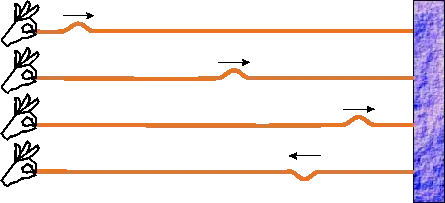

May be, a more mechanic explanation helps to understand:
Imagine you have a long rope, one end fixed to a wall, the other end held by you. By a short stroke upwards, you can create a wave travelling along the rope:
http://wwwex.physik.uni-ulm.de/lehre/physing1/node52.html
(from http://wwwex.physik.uni-ulm.de/lehre/physing1/node52.html)

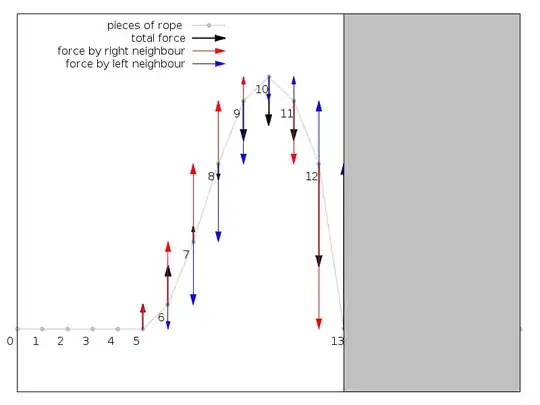

Now, why is it so? Imagine the rope consists of many small pieces, each applies a force to the next and so encounters a force on itself from its neighbours. Let's concentrate on the vertical forces and say the force depends linearly on the vertical distance between the pieces. Here is a plot showing the forces from the neighbours and the sum of those foreces (i.e. direction and strength of acceleration). The wave should move from left to right:
As you can see, piece no 15 encounters an upward force and so is accelerated upwards. Piece no. 14 encounters the same force downwards, plus a larger upwards force from piece no 13 and so on.
Finally, the pieces on the trailing edge (5, 6, 7) are moving downwards, but accelerated upwards, until they come to rest.
What happens at the wall?
Piece 13 can not move, and due to the large vertical distance to particle no 12, no 12 encounters a very strong downwards force. It is punched downwards, and finally, you get a horizontally flipped wave travelling backwards to you.

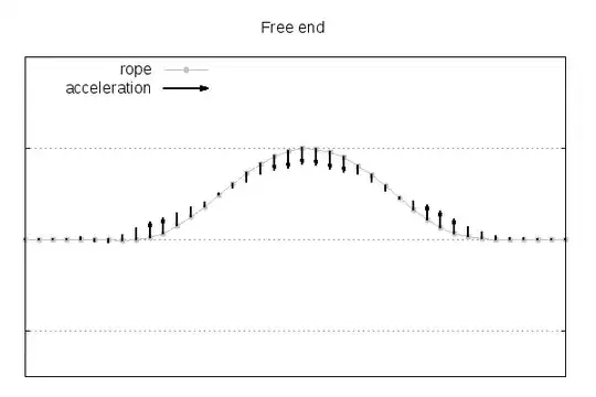

What if the rope is not fixed at all?
Image the rope is cut between piece 12 and 13. For the last figure, this means that no 12 encounters the upwards-force only. Finally, it will rise higher than the maximum of the wave like the tip of a whip, and generate a new, not flipped wave travelling backwards the rope.

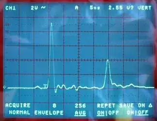

Searched for it yesterday, but didn't find it. Here are scope pictures from a scope directly connected to a pulse generator plus a long cable, stolen from https://hohlerde.org/rauch/elektronik/kleines/kabelradar/index.de.html :
Short-circuit at the end of the cable, you get a flipped reflection:
For an open-ended cable, you get an upright reflection:
With the correct termination, there is no reflection. However, the termination is a little too strong, as you still see a little dip downwards.
By the way, the reflection arrives after about 20ns, so 10ns per direction. At 75% speed of light, this translates to a cable length of about 2.2m.

I had some fun writing a simulation. As above, the rope is divided into several pieces, and the vertical force on each piece is determined from its vertical distance to its direct neighbours. Here it is:
