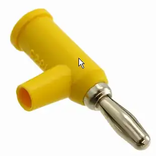

As the data says it mates with a "standard banana". Standard is 4mm.
Something like this:
Or this:
Not this (but perhaps you can see the resemblance in the springy bits):
The part you have (female) is just a hollow tube with no springy parts, so it depends on the male to supply the compliance. Some plugs have a cross-drilled hole so another banana plug can be inserted sideways.

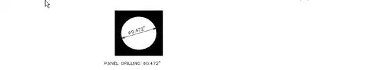

You drill a hole as the datasheet shows and attach the jack to a panel with the large nut.

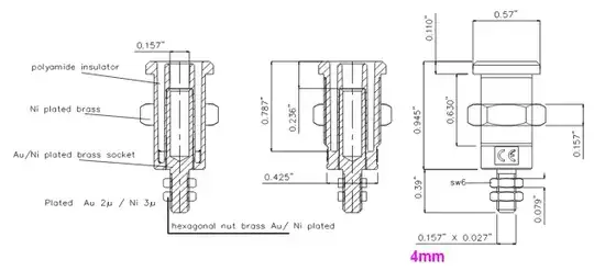

The threaded post on the back is intended for a ring lug. The diameter of the ring can be 4mm or US screw #8. To make a better electrical contact, add a star washer between the nut and the rung lug.
enter image description here Source: Datasheet for the banana jack.
crimp-on ring lug ring lug and star washer
US screw sizes, Metric screw sizes
p.s. Pomona is a reputable supplier. I would expect a better drawing from them. The datasheet claims "IEC" and "4mm". Yet, the dimensions are only in inches, including dimensions of metric threads.
