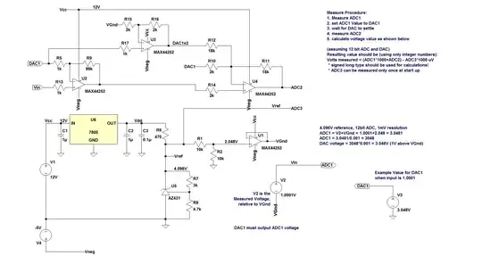

Using summing amplifier you can sum the two DAC outputs. You can use R1=100k, R2=R3=100 Ohm. This way the output will be Vout = -(V1 + V2 / 1000). You'll need dual supply and if you want it non-inverted you need to put another inverting amplifier with gain = 1. So let's say you have 12 bit DAC with 2 outputs and reference 4.096V. Then (if you have second inverting amplifier) one increment from DAC 1 will increase output with 1uV, and one increment from DAC 2 will increase the output with 1mV. That's not 24 bit in total. It's about 22 bits. In theory you you can choose R1 to be 4096 times bigger than R2 and R3 and get 24 bits, but You won't get better results. You'll have a lot of noise problems in microvolts range even if you pick a good low noise opamp.
Update I though it's a question about DAC because I was searching for DACs. Here is how you apply similar principle with ADCs. Instead of summing you have to subtract ADC1 result then multiply by 1000 before measure with ADC2.
Double ADC Resolution
Correction - ADC3 should be on VGnd (Vref/2), not Vref to match the result formula
Instead of AZ431 you can use any other 2.5V reference or another adjustable reference with proper passives to get exactly 4.096V. The less temperature drift the reference has, the better the results. Also it has to be low noise. Note that as is it's probably not accurate enough. It'll be nice to put 500 ohm multi turn trimpot between R7 and R8 with wiper to the reference input and tweak it for Vref = 4.096V exactly. Also a trimpot(2) will be needed between R1 and R2 with wiper to U1 positive input. Tweak it for 2.048V on VGnd. U1 is just any low noise opamp. (BTW AZ431 is awful for the job. I put it because I had the symbol).
It's very critical for U2, U3 and U4 to be zero offset chopper amps. U2 is more important because it multiplies by 100. every 1 microvolt gets to 100 microvolts. If you use OP07 and you zero it properly and the temperature changes with 10 degrees then you get 13 uV offset which translates to 1.3 mV on the output of U4. That's 13 mV in ADC output which makes ADC2 almost useless.
Also U3 must be able to reach 6.048V - that's VGnd(2.048V) + 2xVinmax (2x2V=4V). That's the whole idea of having Vcc = +12V power supply. Vcc can be as low as 6.5V when MAX44252 is used. Since MAX44252 is rail to rail opamp negative supply can be skipped and Vss of the opamp can be connected to ground. That's true for any opamp that can go as low as 48mV on it's output.
MAX44252 has 2-4uV offset voltage (typical) and 1 to 5 nV temperature drift. It's $2.64 on digikey in quantities of 1 and it's quadopamp so only one chip will do the job.
How it works? Let's have 10bit DAC for example. Resolution is 4.096/1024 = 4mV. Input signal must be relative to VGnd, which is half of Vref. ADC1 measures input voltage as normal. Then outputs the value via DAC1. The difference between Vin and DAC1 is the error that you need to amplify, measure and add to the ADC1 result. U2 amplifies the difference Vin - DAC1, relative to DAC1, with gain of 100. U4 amplifies that difference by 10 and also subtracts DAC1, relative to VGnd. That makes ADC2 = (Vin - DAC1) * 1000, relative to VGnd. In other words if you have 1.234567V on Vin, relative to VGnd. ADC1 will measure value of 821 because resolution is 4mV and (2.048+1.234567)/0.004 = 820.64175. So the DAC value will be set to 309 which is 309*0.004V = 1.236V. Now ADC2 will get 1.234567-1.236=-0.001433*1000 = -1.433V relative to VGnd (ideally). That's 2.048-1.433=0.615V common mode. 0.615V / 0.004 = 153.75. So ADC2 value = 154. It's easier to calculate value in microvolts to avoid using float. to convert ADC2 in mV we have to multipy the value by 4: VADC1 = 821*4 = 3284mV. To convert to uV we need to multiply by 1000. Or that's ADC1 value multiplied by 4000. 821*4000 = 3284000. So ADC1 voltage with respect to VGnd is 3284000-2048000 = 1236000uV. The ADC2 is already multiplied by 1000 so we need to multiply only by 4: VADC2 = 154*4 = 616. To get voltage relative to VGnd we need to subtract VGnd: 616-2048 = -1432uV. We take VGnd = 2048uV here because we have x1000 amplification.Now we add VADC1 and VADC2: 1236000 + (-1432) = 1234568uV or 1.234568V
Of course that's just dreams because when you deal with microvolts there will be all kinds of horrible problems - opamp noise, resistors noise, voltage offset, temperature drift, gain error ... But if you use decent parts, at least 1% resistors and you programmatically null the offset and correct the gain you might get reasonably good result. Of course you can't expect to see stable input to the last digit. maybe you can limit the resolution to 10uV (divide the result by 10). Also the multiply by 4 can be done by summing 4 sequential results to have some averaging.
Keep in mind that nothing of this is tested. I simulated only the amplifier stage without taking into account noise and opamp offset. If someone decides to build it write the results in the comments.

  • Question asks about **AD**C. You talk about **DA**C. – dim Jan 09 '17 at 05:28
  • I'm sorry. I searched for DAC and I found this question. I wrote without carefully reading. I'll compensate suggest how to apply the same principle to ADC. – NickSoft Jan 10 '17 at 16:26
  • I removed my downvote, since your post is now related to the question. But I don't think this solution can work in practice. I'm afraid there will be too much inaccuracies. – dim Jan 10 '17 at 20:12
  • Of course it will work. However the accuracy depends on the used parts. There are chopper amps that have 0.1uV offset and 1-5nV/degC drift. Also they have nanovolts 0.1-10Hz p-p noise. Combined with a good reference it could get a stable output up to 10s of uV. But this can work with cheaper parts if you want to gain extra digit. For example 10 bit ADC is with 4.096V reference has 4mV resolution. I think with this circuit it can be improved to 0.1uV resolution with ease (maybe with better reference). That's +/-20000 counts. Of course it'll need software calibration for offset and gain. – NickSoft Jan 11 '17 at 09:28
  • That is all theory. The fact that your ADC2 reading depends on your DAC setting (and opamp offset, but this is not even the most crucial part), that depends itself on your ADC1 reading (and all these having tolerances), will lead to the fact you certainly won't be able to even guarantee monotonic operation of your system (even if you're within the bounds of your calculated accuracy). – dim Jan 11 '17 at 09:57
  • Ah, yes, I can explain it now: the problem is that your DAC will have +/-0.5 LSB of accuracy (it can't do better - no DAC does better). So anything dependant on that will later have this inaccuracy, including your ADC2 reading. So in the end, you'll be trying to read something with µV precision, which has mV inaccuracies in it. Unless you use a DAC that is accurate at least to ADC1 bits + ADC2 bits. But if you can afford a 32-bit DAC plus two 16-bit ADC and a few very-high-precision opamps, you'd better off buy a 32-bit ADC from the start, and have a much simpler circuit. – dim Jan 11 '17 at 10:31
  • That's the idea. The actual input voltage is compared with the DAC. The difference between the input voltage and DAC output is the inaccuracy of ADC1. That difference is amplified 1000 times and measured by ADC2, and then added to ADC1 value. **The DAC HAS TO BE THE SAME RESOLUTION AS THE ADC!** The resolution error doesn't matter, because the error is amplified and measured by DAC2, and accounted for. That also means that if ADC1 has some error up to +/-0.5 LSB it'll be corrected by ADC2. – NickSoft Jan 11 '17 at 13:21
