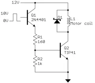

The high side switch configuration, in circuit B, will still work, but it will be a bit slower. This is due to the parasitic capacitance between the base and emitter. For the low-side switch in circuit A, the parasitic Cap is grounded, so you have just to charge it pumping enough current thru the photo-diode. For circuit B, the base-emitter capacitance will float, working against the charge-discharge making the circuit a bit slower to turn-on / turn-off.
    Genuine query: why will that make a difference? Can you expand your answer with an equivalent circuit schematic? There's a schematic button on the editor toolbar. – Transistor Oct 14 '16 at 00:33
