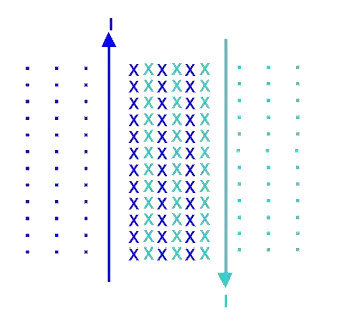

So why doesn't this circuit radiate well at low frequencies? Because the wires are too close together! Let's look at the magnetic field around a DC circuit. Here's another image showing the direction of the field around current-carrying wires. Our wires have currents flowing in opposite directions, like the pair on the right.
Magnetic fields and forces between current-carrying wires
Here's a top-down view:
Top-down view of magnetic fields around a pair of wires carrying currents in opposite directions
The wires produce magnetic fields that circle in opposite directions. Between the wires, the fields point the same way. Outside of the wires, the fields point in opposite ways. Thus, outside of the wires, the fields (almost) cancel out! This happens because the current is constant everywhere in the circuit. At low frequencies (long wavelengths), this is approximately correct.

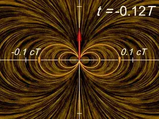

Here's a dipole from MIT being slowly powered down, envisioned using something called dynamic line Integral convolution.
When field completely disappears, white noise is left remaining. It takes time for this white noise to propagate to all outer parts of the field. The limitation is the speed of light. As soon as there is 0 field at the dipole, this information (displayed as white noise) radiates outwards in a perfect sphere in all directions at the speed of light.
If the dipole suddenly disappeared you would just get the white noise moving outwards and engulfing the original field, with no visible transition.
The closed loop behaviour of EM waves appears when there is a slow transition. When the dipole is immediately transitioned to a new field strength, the new state of the field radiates as a perfect sphere. When there is a slow transition, a visible wavefront forms which consists of each intermediate field strength that is transitioned through. The field is not spherically shaped and each intermediate field strength is attempting to propagate a new torus shaped field line pattern originating from that particular field strength. The result is a spherical wavefront consisting of closed loops which eventually unpeel to form the final torus shaped state of the field.
The wavefront becomes more pronounced and visible the larger the torus shaped field lines are stretched into the spherical radius of propagation. The point at which is becomes large enough to be visible is the boundary between the non-radiating Fresnel zone and the radiating Fresnel zone, which is λ/2π. This can be seen in the difference between these two animations (shown at the bottom of the answer).
