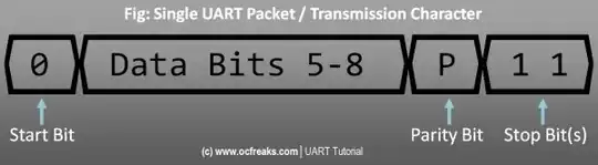

All ASCII characters are 8bit wide, you can see that in an ASCII table. HEX values of ASCII characters does not go beyond FF (1111 1111)
UART cannot receive more than one data byte (8bits) at a time, also beside that 8bit data there are STOP and START bits, PARITY and a few more, which you can see at picture shown below and which together form UART communication packet.
So when you sending ASCII characters to UART, you're sending them one by one, and thats how string is made. You already know that string is just an array of characters.
