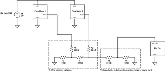

I am attempting to read two flow meters through the mic port of a phone/tablet. The flow meters' pulse pins toggle between +0V and +5V as their pinwheels rotate. I use an R-2R to combine the pulses from the flow meters. My first attempt was to simply send the digital output from the R-2R straight into to mic port like so:

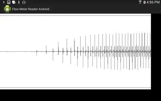

The problems start when sending the same signal to my Galaxy Note 8 Android tablet. This is what the signal looks like when one of the flow meters is spinning and changing state, read through my PC's mic port: single flow meter through PC
(source: awesomebox.net)
Here is what the same signal looks like when read through the tablet's mic port: tablet flow meter signal
Because of the (stronger?) AC-coupling in the tablet's sound card and the noise cancellation and other processing done to the signal, it is not possible to use the same edge detection method.
I was suggested by @DwayneReid to not try to force a digital signal through. Instead, I should convert the digital signal to an analog one and pass that through. He suggested this schematic for converting the digital signal into an analog one:
I combined this schematic with mine and came up with:

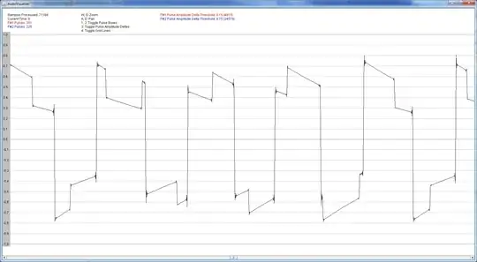

This is what the signal now looks like when one of the flow meters is spinning and changing state, read through my PC's mic port: reading with 555
As you can see, there is a now a slight oscillation present in the signal. However, the overall signal is unchanged and none of my expectations are met. The constant analog signal is so slight it could be considered noise. Changes in voltage seem to effect the signal no differently than before.
Where is my schematic wrong? How can I get a generate a constant analog signal that changes in either amplitude or frequency when the combined voltage from the flow meters changes?

Many thanks for posting your schematic. This makes things much easier.
1) You can eliminate R8. I included it because I didn't know what the output impedance of your R-2R network was.
2) Optimize the 555 frequency.
a) temporarily replace the flow-meters with SPDT switches such that you get Vdd & Vss at the switch wiper as you flip the switch one way or the other.
b) set the output of flowmeter #2 HI.
c) Observe the waveform on the target device. Vary the 555 frequency until the amplitude isn't being rolled-off at the high end. I was guessing that 10KHz - 20 KHz would be good - but I don't know.
Basically, start with the frequency high and observe the amplitude as you change the frequency downwards. You want to pick the frequency such that the amplitude response is flat at that point.
You may find that you need to attenuate the signal if this is going into a mic input instead of a line-level input. That's easy - just add a shunt resistor across the input to the computer until the amplitude is at the appropriate level.
When things are optimized, flipping the switch for flow-meter #2 should give you a clean amplitude change: nothing to something.
Now test flow-meter #1. You should see a smaller but completely-reproducible amplitude change.
Please post your results - I'll offer more comments.
