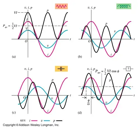

Note that in the diagram above, the angle between real and reactive power is 90 degrees always. Following on from further comments, the diagram below should help clarify a few things about reactive power: -
There are four scenarios, resistive, inductive, capacitive and mixed loads. The black curve on all four is "power" i.e. \$v\cdot i\$. Note that for the inductor and capacitor, the power has an average value of zero.

  • See this diagram for instance: http://www.physics.sjsu.edu/becker/physics51/images/32_10_Power_in_RLC_circuit.JPG - it shows voltage, current and power waveforms for resistors, inductors and capacitors. You should be able to see the cyclic nature of energy going in and then presenting itself back out. – Andy aka May 11 '15 at 10:30
