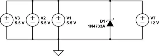

simulate this circuit – Schematic created using CircuitLab The three voltage sources on the left represent the solar cells, with the NiMH battery on the right.
I was wondering if I needed any additional components if I were to use three 5.5V solar cells in parallel outputting 40mA (16.5V total at 40mA, regulated to 13.3V by the zener) in order to prevent overcharging.

  • Hi, Jacob. Thanks for visiting this forum! There are several problems with your question. First, Can you provide a link to the actual solar cells you are using? They generally have a Voc and Isc rating. Voc = open circuit voltage, and Isc = short-circuit current. There may also be a peak power voltage specified. All these will be helpful. Second main thing is that the solar panels in your schematic are drawn in parallel, not in series. When put in parallel, the currents add and the voltage is the same as one unit. So you should probably redraw the schematic to put them in series. – user57037 May 09 '15 at 22:48
  • Also, a reverse-biased zener does not have a ".6-.7 volt drop". You're thinking of the voltage drop for a forward-biased diode, and that doesn't apply here. – WhatRoughBeast May 10 '15 at 01:41

First of all, you have the three 5.5 V solar cells in parallel. They need to be in series to generate 16.5 V.
NiMH batteries are usually charged using special IC's made for this purpose since they require special monitoring. However at the low level of current you have available (40 mA) you can get by with a much simpler charger as mentioned here. You need to make sure the current doesn't go above this level (it needs to be below 0.05C, where C = 800 mA). If the current does go above this, up to C/10 (800 mA), then you need to add a timer so the charging cycles is not more than 3 hours.
You need to replace the 5.1 Zener with a 12 V one, such as the BZX85C12. In addition, you will need to add a 110 Ω resistor between the output of the solar cells and the Zener. The value is calculated by dividing the voltage drop 16.5 V - 12 V by the full-load current of 40 mA. At no load, the Zener will dissipate 0.04 A * 12 V = 500 mW, or half the maximum rating (1 W) of the diode.

  • Ah, confused my panels, thanks for the correction. So even though the battery can be charged up to ~13.3V I would still use a 12V Zener? – Jacob Riggs May 10 '15 at 13:20
  • @JacobRiggs I assume you will be feeding the battery into a load most of the time. If it can tolerate the 13.3v then you can use the higher voltage Zener. I would choose 1 13v one, such the [NZX13A](http://www.nxp.com/documents/data_sheet/NZX_SER.pdf). You should reduce the value of the resistor to 91 Ω. – tcrosley May 10 '15 at 18:37
