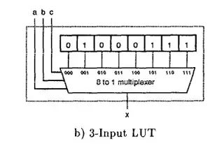

The LUT is actually implemented using a combination of the SRAM bits and a MUX:
Here the bits across the top 0 1 0 0 0 1 1 1 represents the output of the truth table for this LUT. The three inputs to the MUX on the left a, b, and c select the appropriate output value.
