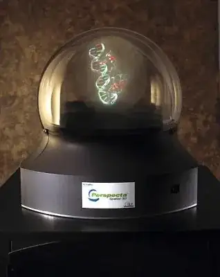

“Swept motion volumetric projected screens” seems the most promising. perspecta enter image description here

1) Perspecta. In it a "high speed projector" projects 198 768x768 pixel "slices" at 24 Hz on a rotating screen (rotating at 730 rpm).
The projector is a "5kHz MEMS-based".
The slices are projected at approximately 6000 images/ s by a group of three Digital Micromirror Devices, microelectromechanical systems- (MEMS-) based spatial light modulators (Texas Instrument, Inc. Plano, Texas).
