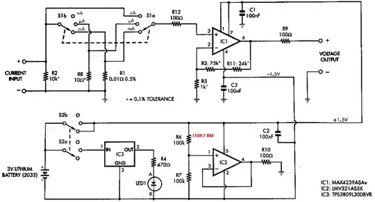

Nano amp amplifiers possible relevance.
Added here to form part of a resource.
Maxim MAX4238 MAX4239 low offset "chopper stabilised" opamps
Application circuit Nanoamp to milliAmp DMM adaptor using this OIC
I recommend making R6 = 150k
