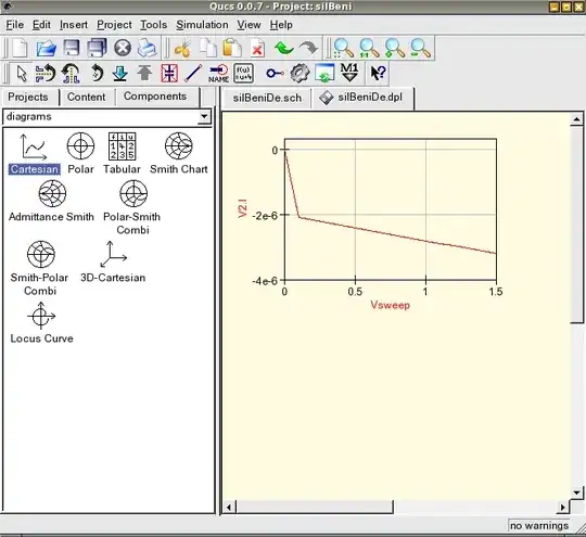

If you look at this picture:
VSweep Example
(source: infn.it)
You can see that \$V_{SWEEP}\$ goes from 0V to 1.5V, and the output (V2.1) is calculated for each point along that sweep as the output from the circuit if the input were what \$V_{SWEEP}\$ was at that time.
