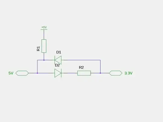

I came up with this circuit:
I don't know if it will actually do what I want, but from reading other sources (including Is it possible to drive TTL inputs from 3.3v microcontroller and Bi-Directional Step up and Step down (3.3v <-> 5, etc) [the latter mentions a sparkfun tutorial that no longer exists]) it might.
My thinking is, data from 5v to 3.3v goes through D2 and the series resistor R2 to drop the voltage. Data from 3.3v to 5v goes through D1 and gets pulled up by R1.
Would this work? Is it complete gibberish?

I vote gibberish :-).
You won't get much voltage drop over R2 since there will hardly be any current, and therefore the diode won't drop much voltage either. If your 3.3V device isn't 5V I/O compatible you may fry it this way.
Also if the 3.3V device outputs a low level we can ignore D1, and the level at the 5V input will be determined by R1, D2 and R2. R1 + R2 will lift the low level up to a certain level, and the diode will add another 0.7V, so the level seen on the 5V side may not be low at all.
Back to the drawing board?

That circuit is broken. Just for one, consider the case of the left side driving 5V and the right side high impedance. The right side will go to 5V minus the diode drop. It's also broken for other cases. Go thru all 4 possible cases you'll see the result isn't what you intended.

I see you have posted a revised circuit, but it still has problems. When the 5V side is driving low, it can bring the 3.3V side only down to 2 diode drops above ground. That is too high for some logic types. For example, many PIC microcontrollers have Schmitt trigger inputs operate from .2Vdd to .8Vdd. .2Vdd would be only 660mV with 3.3V supply, so two diode drops is too high to guarantee a logic low.
This is getting silly. Even if your circuit worked, it would only show that if you use enough chewing gum and duct tape and 6 parts you can sortof make something that's not quite as good as a single cheap IC in a SOT-23 packge.
