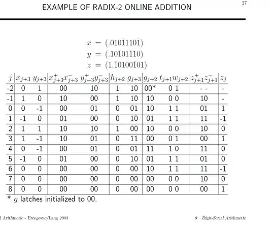

I am working with OLA adders the borrow save module for signed digit addition I implemented the added in vhdl modeling the following picture adder
I have run the following example as given in the table and got the same result but with a glitch on the first Zp since it has 2 registers and stays unsigned output for the first 2 cycles
I have did the subtraction manually using basic sub and got different results I do not understand why
manually I did: 0010000110100001 - 1000010010010100 the result i obtained is : 01001110100001101 which is different of the result obtained in the table

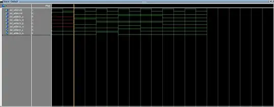

EDIT: I tried the simulation of fig2 diagram with the following
X = 01 00 10 10 and Y = 00 10 11 10
as 74-46 the obtained result is Z : 01 10 00 00
which is not equal to the hand made calculation of 00 01 11 00
the following is the simulation and I added 2 cycles of 00 00 simulation OLA adder

As you know, signed-digit representation uses two bits to represent each digit. Olivares says "the first bit is weighted negative and the second bit is positive weighted".
The example posted -- Ercegovac and Lang, "Digit-Serial Arithmetic", p. 27; also Ercegovac and Lang, "Digital Arithmetic", p. 507 -- uses a slightly different signed-digit representation -- the left bit is weighted positive and the right bit is weighted negative.
   00 10 00 01  10 10 00 01 (x) represents
   +0 +1 +0 -1  +1 +1 +0 -1 =
         +0011  1011 = 0x3b = 59
   10 00 01 00  10 01 01 00 (y) represents
   +1 +0 -1 +0  +1 -1 -1 +0 =
         +0110  0010 = 0x62 = 98
Summing those numbers should produce 59 + 98 = 157.
The adder circuit shown has internal nodes h, g, t, w used to produce the final output value z.
The output of the adder circuit:
   10 01 11 10 00  11 01 11 10 (z) represents
   +1 -1 +0 +1 +0  +0 -1 +0 +1 =
           +01001  1101 = 0x9d = 157
which is one of several valid ways to represent 157 in signed-digit representation.
With the circuit you show, the interemediate values h, g, t, w and the output value z will not give exactly the same bits when adding 59 + 98 as they do when adding 98 + 59, but the two different output bit patterns are both valid representations of 157.
