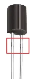

I am using an IR LED and a photo diode, and I have designed the PCB according to the specifications that I found on the datasheet - i.e. hole sizes for the pins being 0.6 mm. However, on these components there are 'knuckles' (see below image) and these are wider than the hole size they quote for the pins.
Enter image description here
So the issue is the component doesn't go low enough into the board because of these knuckles. Why are they there? How can I know how wide they are in order to make my holes account for this?

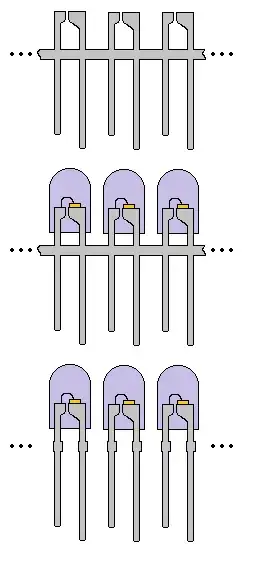

  • They are a remnant of the production process (see picture below).
    First the pins are a part of one single metal sheet and are cut after the dies and the casings are added. The cutting leaves the knuckles.

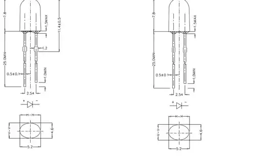

Edit: There is no shortage of poorly specified LED drawings- even from relatively well-known makers. For example, here is a fairly good one from Cree.
You may note that there are two lead frame variations, one with and one without the "knuckles" (as Russell mentioned in his answer), however the one without still has artifacts where the joiners from the continuous leadframes were punched out (as Curd mentioned). Unfortunately, the artifacts are not dimensioned either in size or position (and one might assume that they fit within the tolerance of the leads 0.5+/-0.1mm but I seriously doubt that is guaranteed to be true). The ones with larger knuckles have only a nominal dimension of 1.2mm, so we don't really know if a 1mm hole (for example) will allow the LED to pass through or not. The first shipment might be find and the next not, and there's no complaint one could make from the specs. Chances are a hole of 0.8mm would work, but there are no guarantees. I have other paper datasheets from really major Taiwan-based suppliers that are no better (and some are worse). The best you can do as a small quantity user is to employ the calipers (see above) on a sample and hope they don't change leadframe suppliers etc., or switch to a supplier with tighter specs.

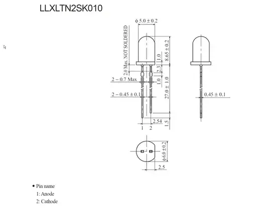

Below is a much more tightly specified datasheet drawing (from this Panasonic datasheet) that tells you all you need to know:
I believe that the "knuckles" here (as I opined on yours) are not intended to stop the LED from going down as far as possible- they're just artifacts of the manufacturing. The maximum dimension is specified, but no minimum, so there is no guarantee. However, there's a 2mm spec that indicates that a 2mm spacing is required under the LED (at least that's my interpretation- that it's a minimum not a maximum). This is to help keep the LED from being destroyed by differential thermal coefficients of expansion, both immediately after assembly and during operation. Note that it's above the top of the "knuckles" so it's acceptable to have the "knuckles" inside the PCB.

The "knuckles" are called "stoppers" (by at least some component manufacturers, and are intended to both allow & cause the component to sit in a fixed alignment both:
relative to the plane of the PCB and above the PCB surface.
The body moulding of components such as LEDs are less constrained dimensionally (aka built with less intended accuracy) than the frame and leads, and seating components bodies against the PCB surface will which cause greater average misalignment from the vertical. Components that emit or detect radiation may have their performance and/or appearance affected by such misalignment.
