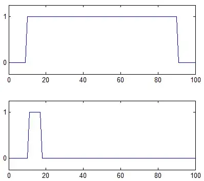

Problem: I have to short-circuit two pins on a mainboard (power switch) when a rising edge on a control wire (voltage is turned on and stays on) is detected, but these two circuits have to be separated without any direct connection, so I can't just plug the computer on the voltage but have to use some sort of relay, which closes two contacts (but only for a short time) when powered.
The wave form would look something like this:
What is the name for this type of circuit?

The solution is called a monostable multivibrator, or MMV. When it detects a rising (or falling) edge it gives a pulse at the output with a chosen duration. You use that pulse to trigger the relay. This is a typical job for an LM555 timer.
If the signal to be switched is DC you can use an optocoupler, like Matt suggested. A CNY17 may be a good choice. If the signal is AC you could use an SSR like the LH1500, or a reed relay. I wouldn't use a power relay because they're not made to switch low current signals.
