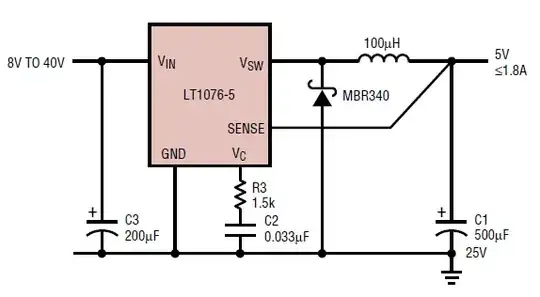

The working principle of switchers is a bit more complicated than that of a linear regulator, but it's not extremely difficult. Thanks to their advantage of offering high efficiencies they're used everywhere these days, and there's a plethora of regulators available. Olin mentioned Linear Technology, they're one of the leaders in the field. They're not the cheapest, but if you just need 1 that's not as much of a problem as for 100k/year, for instance. Their website offers a parametric search, which with my parameters returned something like 16 parts, so there's plenty of choice. I picked the fixed output voltage LT1076-5 (disregarding cost):
LT1076-5
As you can see this is hardly more complicated than a linear regulator, so what's the problem?
  1. Switchers sometimes switch at rather high frequencies (MHz range) which causes EMI. This one works at a lower 100kHz, less EMI, but a bit bigger coil. Not a big deal.
  2. You can achieve very high efficiencies with switchers, but to get that last % out of it you need to select components very carefully and pay much attention to the PCB layout. If you're not yet experienced in SMPS design you may have an efficiency of only 85% instead of the maximum 90%. Again, no big deal.
Crucial components are the coil, the diode and C1. They're also the parts which need attention in the layout: the loop L1-C1-D1 must be kept as short as possible, and also the connection between IC and coil. Use wide traces because they will carry high currents.
On second thought this is not the ideal datasheet. In fact it's pretty brief for an LT datasheet. It doesn't have a single graph, and many other datasheets give you lots of information on component selection. Check other parts if you want to learn more. (update: the datasheet for the LT1076-5 seems to be more of an addendum to that of the LT1076, which is more extensive)
The datasheets for the LT1766 and LT3430 are more LT-like, with nearly 20 pages of application information, including calculations and board layout. Read them and learn! :-)
OK, this was about LT. Yes, I'm a fan (very good support too, at least for professionals), but there are others of course. National has its series of Simple Switchers and has a Webench designer which gives you schematics complete with BOM. Much cheaper than LT too.
