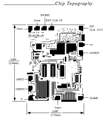

If you take a look at the datasheet of TI(or a few other companies) Op-Amps you will come across with "chip topography" or "diagram(schematic)". for example:

or:
figure2

Questions about the chip topography:
  1. What is/are the usage of chip topography for an EE? because the many of information for the chip topography of a chip is mechanical while we are EE. that's interesting to me that you can see the chip topography of ICL7650 in the MAXIM datasheet but there is no schematic for it. I think the schematic is much more clear than the chip topography then why there is no schematic for it?
  2. Have you had any experience to use chip topography in your design? what was that?
  3. Why while there is a clear schematic, they put chip topography?

As mentioned in another answer, the die diagram is helpful if you are buying the chip as a bare die and doing chip-on-board or hybrid assembly.

Chip topography is useful only if you can get the chip as a bare die. You need to know the precise locations of the bond pads in order to wirebond it to the board. Schematics are not exceptionally common, generally you will get block diagrams and simplified schematics of particular components, especially I/O circuitry. Schematics can be useful to understand how the chip works and possibly for building simulation models.
